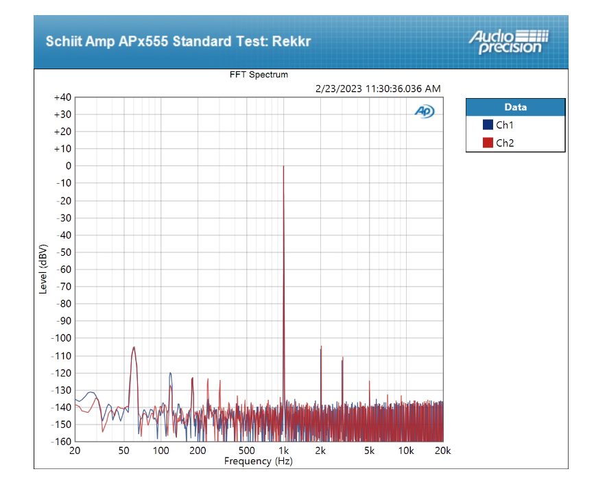

segnalo il piccoletto sicuramente un suono piu che ottimo visto il profilo armonico...per 200€ x chi non usa il saldatore

All right, so I put the little giant Rekkr into my main system today. The dissonance in scales between it and the rest of the gear is just ridiculous! The speakers completely dwarf it, you could easily mount it inside them. I run a Topping D90, a Freya S preamp and B&W 803 D2s. Currently I'm playing around with Purifi 1ET400A modules for final amplifiaction (thus the bare boards in the background).
I never heard a 2 W amp in person before, so please excuse me here for a minute, but I genuinely wasn't ready for what came out of the speakers. It can run the B&Ws no problem, about half tilt on the preamp (in passive attenuation mode) was the limit of what I feel comfortable exposing my neighbors to. It did start to break apart just past this point, with distortion becoming audible, and at full tilt it was completely un-listenable, but also significantly louder than what I wold consider a comfortable listening volume. As long as it was kept left of the hockey-stick point on the SNR graph it sounded identical to the Purifi, all of the sound was there, bass, sub-bass, mids, highs, *insert whatever audiophile babble*, it's all there.
The "headroom" crowd can seriously take a hike, this proves to me definitively that SNR at voltage swing is all that defines the output at the speakers, especially since the 803s are often taunted as "power hungry" and needing large wattage.
In case anyone is curious, the speakers are about 3 m away from the couch and 2.3 m apart, along the long wall in a 5.0 x 3.8 m room. To be fair, I probably fall on the lower end of the how-loud-is-loud bell curve, but still, I don't think my assessment above too far off.
With the preamp fully open and CD player on pause, there is absolutely no hiss or any other sound coming from the speakers with my ear touching the tweeter grill, so that claim from Shiit is justified.
After an hour of driving the B&Ws, the cooling fins got hot to the touch, but I could keep my hand on top of the heatsink. The rest of the case was warm, but significantly less so. The unit also gets fairly warm just sitting at idle.
Hope someone finds this interesting and sorry for the poor picture quality.
