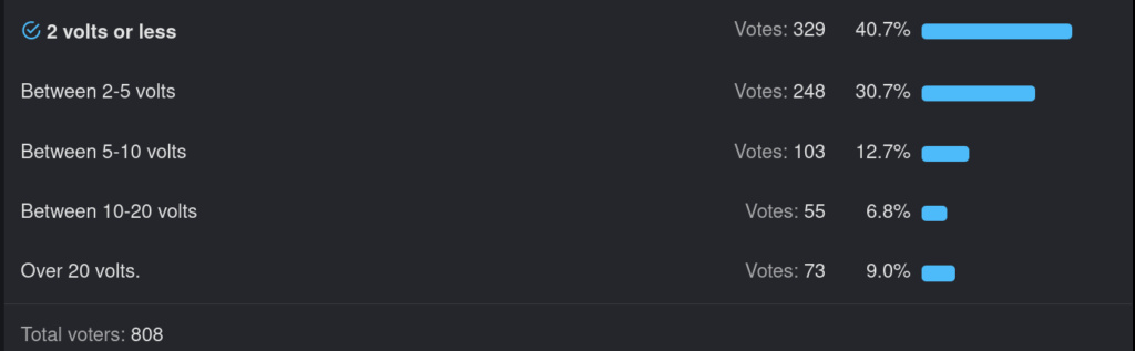

Di potenza ne serve veramente poca
1 volt into 8 ohms = 1/8 watt
10 volts into 8 ohms = 12.5 watts
28.3 volts into 8 ohms = 100 watts
