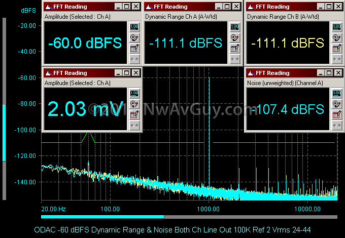

DYNAMIC RANGE: A DAC’s noise floor impacts Dynamic Range (DNR), audible noise, THD+N, and can even exceed jitter-induced distortion. If you have to pick a single number to evaluate real world DAC performance –60 dBFS dynamic range (DNR) is one of the most revealing. The guys in the white lab coats have determined DNR greater than 100 dB results in transparency under realistic conditions. And, if you want to adjust the volume in software, it’s best to have at least 110 dB DNR to keep the noise floor inaudible even if the downstream gain is left cranked way up. Anything beyond 110 dB is past the point of diminishing returns—it looks nice on paper but doesn’t help the sound quality. The ODAC is a very substantial 14 dB better than the FiiO E10. Here’s both channels of the ODAC referenced to the 2.03 Vrms at 0 dBFS. Note the channels are very symmetrical indicating a careful PCB layout:
ODAC VS ESS: As explained earlier, the DNR quoted on datasheets is often something of a Holy Grail. The chip specs are typically from a very high quality AES/EBU or I2S laboratory quality signal (as output by high-end audio analyzers like a Prism dScope or Audio Precision). And they’re typically running from expensive ultra low noise bench power supplies costing thousands of dollars. It’s safe to assume the datasheet numbers were not made with USB data while running on USB power. ESS rates the ES9023 DNR at –112 dB A Weighted. The ODAC delivers –111.1 dB A-Weighted under the same conditions. In other words, even using USB data and power, the ODAC comes within a fraction of a dB of achieving the datasheet spec! I’m fairly proud of this aspect of the ODAC. It wasn’t easy.

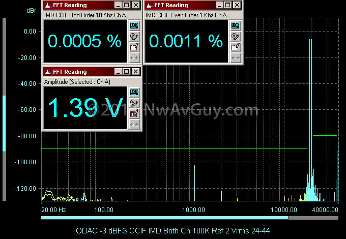

CCIF IMD: This 19+20 Khz twin tone is a difficult test for many DACs running at 44 Khz. Old style (NOS) non-oversampling DACs especially struggle due to aliasing problems. In addition the output buffer (or I-V stage) in many DACs contributes high frequency distortion because the RC filter can be a challenging reactive load at these frequencies. If you look back through my reviews, you’ll find lots of products struggle on this test. Even the E10 turned in a marginal result. The ODAC, however, due to careful optimization of the output filter, and the superior digital filtering of the ESS DAC, does very well here with everything in the audio band well below 100 dB (both channels shown). Note also the 19 and 20 Khz tones are visibly equal in level which is not the case for many DACs:

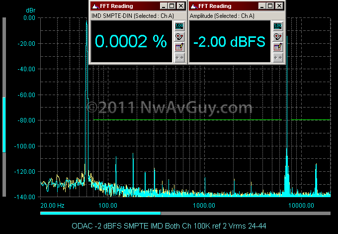

SMPTE IMD: This twin tone test is more revealing of low frequency problems including power supply interaction. Again, the ODAC does very well with everything well below 100 dB (both channels shown):

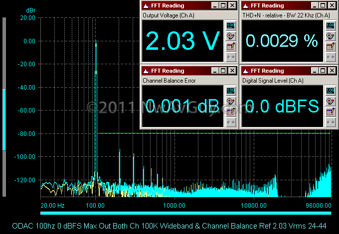

100hz THD+N @ 0 dBFS: This test checks for clipping of the DAC at 0 dBFS and also shows the maximum output and channel balance error. You can see the ODAC produces 2.03 Vrms which is within an in significant 0.03 volts of the Redbook standard for digital audio. And even at 0 dBFS, the distortion is still 3 times less than what’s required for 100% transparency. The channels are perfectly balanced to within 0.001 dB. This spectrum is shown all the way out to 96 Khz and you can see the ESS DAC is well behaved even above 20 Khz with all noise still below about –110 dBFS. This is excellent performance:

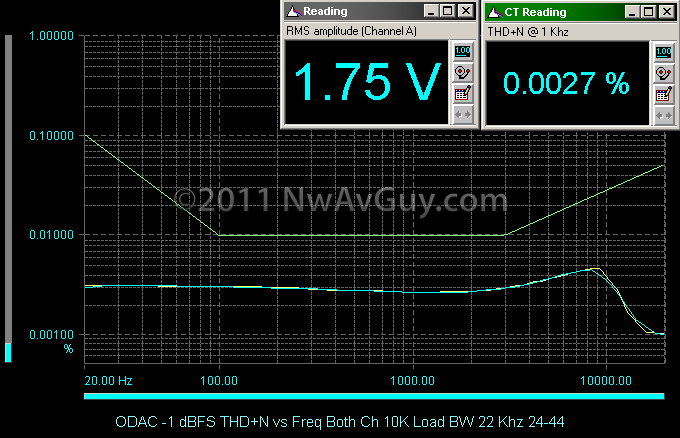

THD+N VS FREQUENCY: Here’s the distortion performance at –1 dBFS from 20 hz to 20 Khz into a more challenging 10K load with a measurement bandwidth of 22 Khz. At 1 Khz the distortion is only 0.0027% and it remains around 0.003% over most of the audio band with only a slight rise up to 0.0048% at 9 Khz before the harmonics fall above the audible range. This is excellent performance and both channels are very closely matched (yellow vs blue):

Il tizio dell'ODAC purtroppo fa troppe assunzioni dando per scontato che quelli che ascoltano musica siano oscilloscopi e analizzatori di spettro di frequenza; è qua il suo più grande errore: siamo esseri umani e ascoltiamo con le nostre orecchie, non con oscilloscopi.
Ad oggi ancora non si riesce a capire, al di là delle personali preferenze, cosa è che rende piacevole o affaticante un suono. Ci sono speculazioni, c'è gente che dice che il jitter rende affaticante il suono... ma è vero?
Cosa succederebbe se qualcuno un giorno scoprisse attraverso una serie di test che l'orecchio umano gradisce attualmente una certa quantità di jitter e trova "anomalo" una risposta in frequenza perfettamente lineare?
L'ODAC è un bellissimo esercizio di stile ma come moltissime persone potranno testimoniare esistono DAC migliori e che alle loro orecchie suonano meglio.
E come è possibile? Ci sono misurazioni dettagliatissime, dovrebbe essere il miglior DAC presente sul mercato stando ai numeri.
Evidentemente le specifiche non sono tutto. Wink
